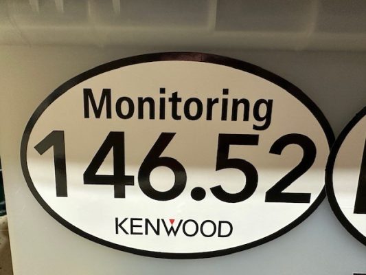

    You mention the frequency of 146.59. I take it you are talking about 146.52 National Calling Frequency (Simplex). K3MRI gave a great explanation. There are other radios like Alinco that have had the priority feature.
    On a different note, A wile back, Kenwood was giving stickers that had “Monitoring 146.52.” printed on them.
    When I have gone to Hamfest, sometimes I make a sign or with white shoe polish I write 146.52 on the glass, and when I operate APRS, I do add “Monitoring 146.52”
